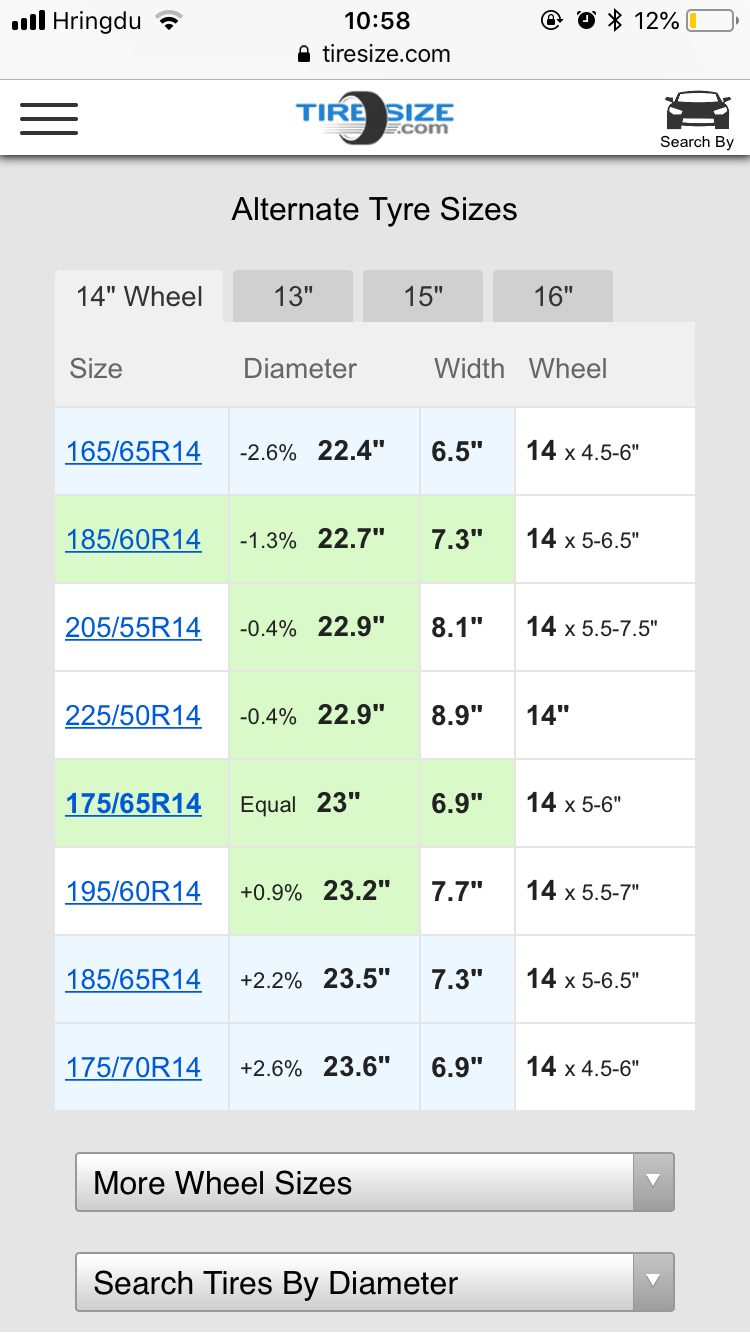

Pósturaf Viktor » Lau 22. Sep 2018 10:59
Michelin > Nokian
Grænu passa:
https://tiresize.com/tyre-size-calculator/
